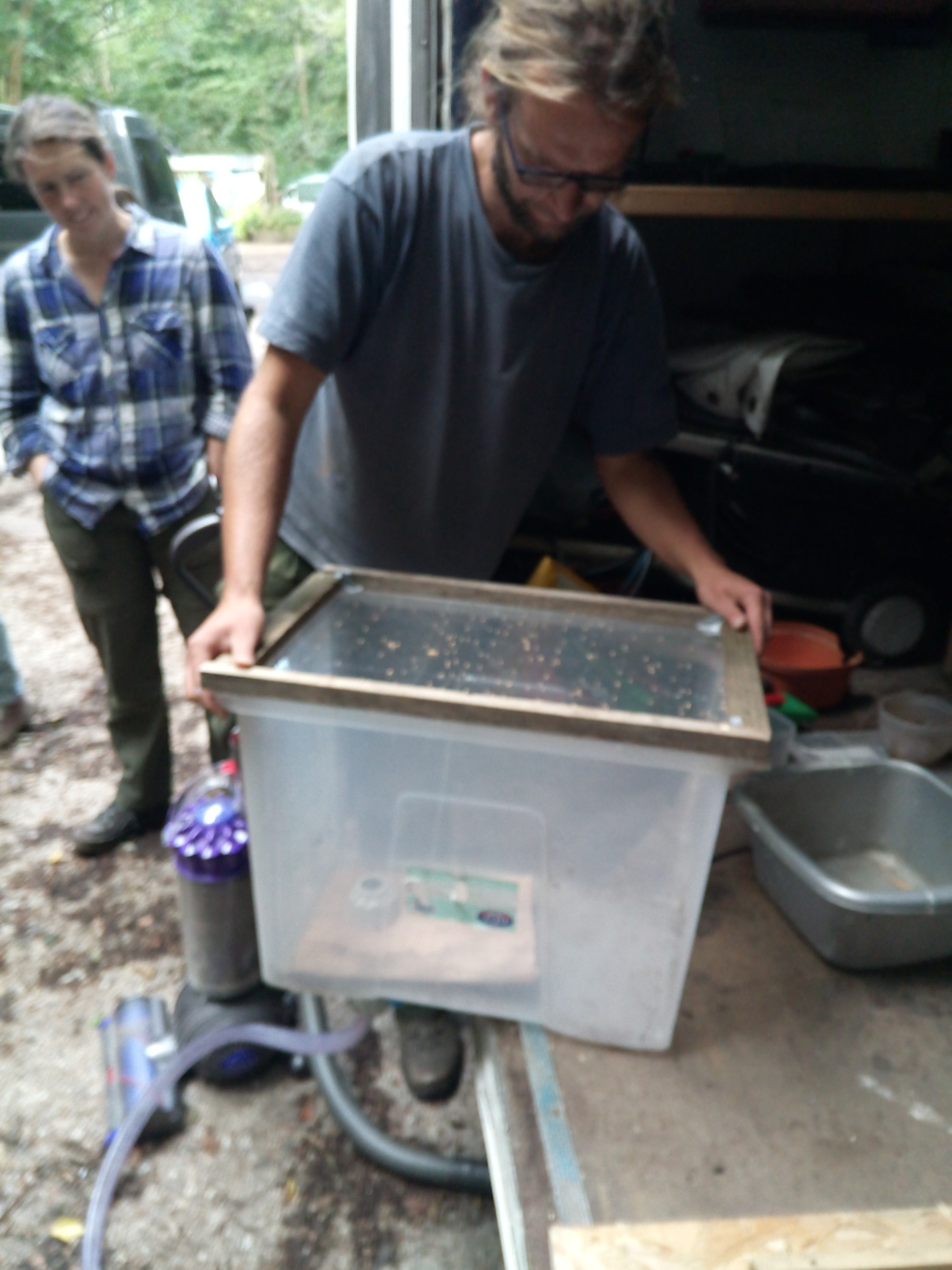

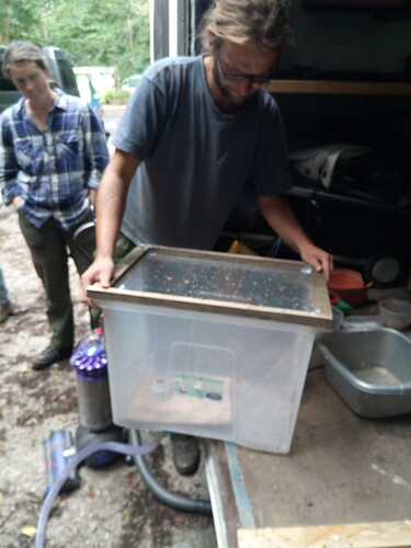

The box we used was ridiculously large as it was the one we had lying around. We’ll cut it down now we know it works.
We didn’t do any drawings as such, just learned by doing having watched a youtube video some months ago.
Steps
  • Drill small holes in a piece of acrylic, sandwiched between two sheets of ply

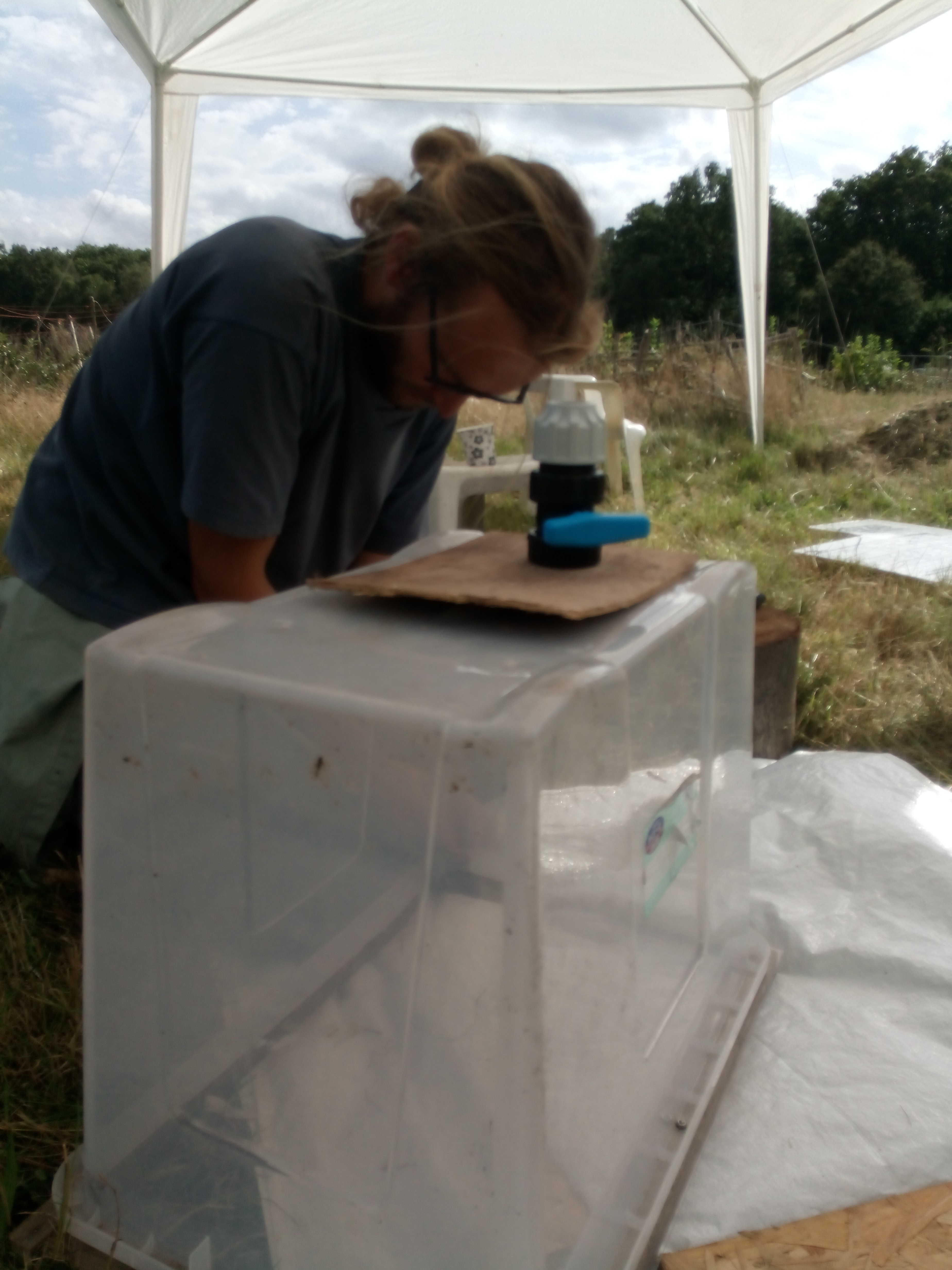

  • Add a pipe fitting to a (sensibly sized) plastic box, use a couple of thin bits of ply or aluminum to strengthen the box around the pipe fitting
  • Bolt the piece of acrylic to the plastic box
  • Add a lip around the acrylic so the seeds don’t fall off
  • Make a jig/guide for your seed tray to make lining up the holes easier
  • Bang some nails into the sheet of ply you’ve drilled through to make a bonus dibber/ plug pusher tool.
