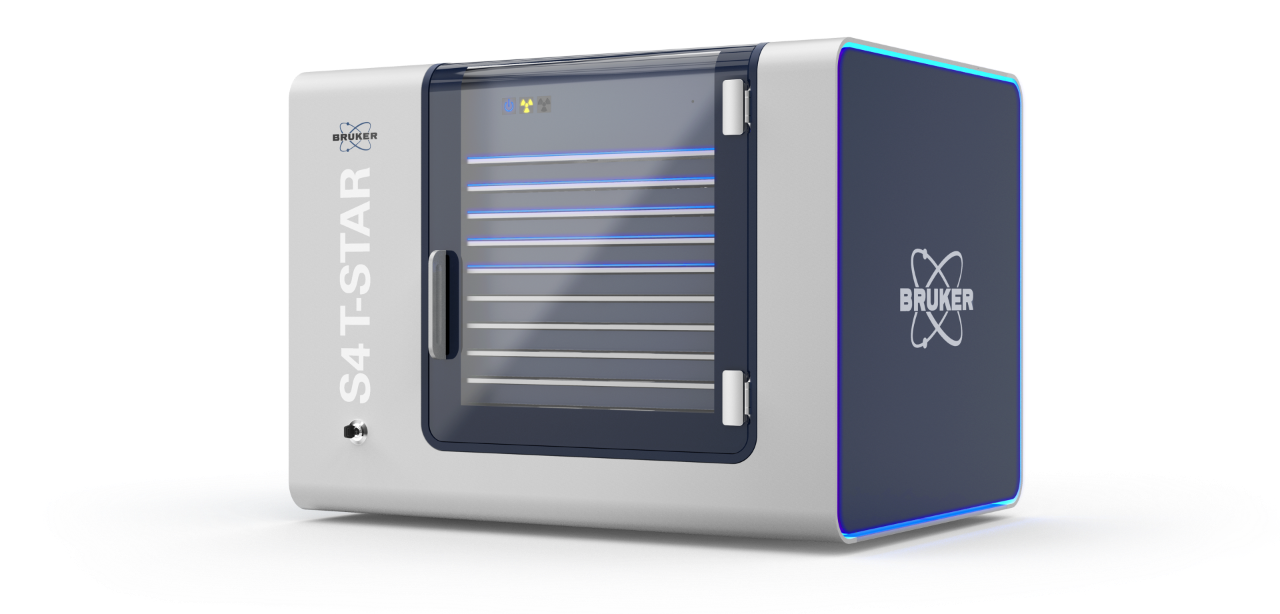

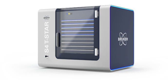

High Performance TXRF Spectrometer for Ultra-Trace Element Analysis
ppb xrf
