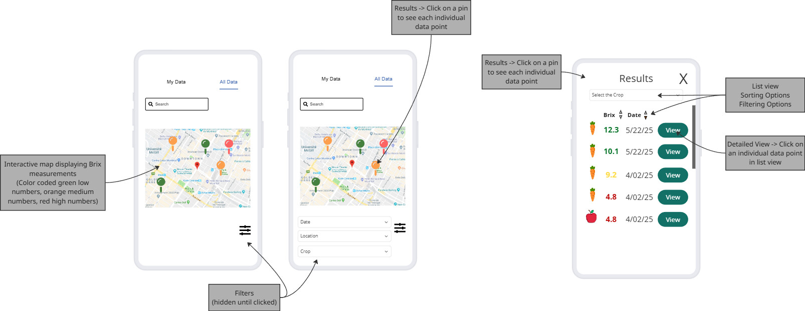

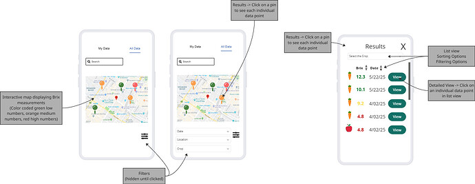

The application we are working on is meant to serve citizen scientists who want to enter data (primarily BRIX scores measured from refractometers) and meant to serve folks who want to use these scores to make decisions about where or what to eat.
In this application, we are envisioning a map-based interface where users can see the data previously entered within a radius (for example < 5 miles, within a 10 mile radius, etc.). This will require clustering of data points which the user should be able to click on each cluster and see a list of individual data points/values. We would also like to color code the data points based on whether the score is high or low (red to green). Finally, we are imagining filters for date, location and crop type while searching on the map.
